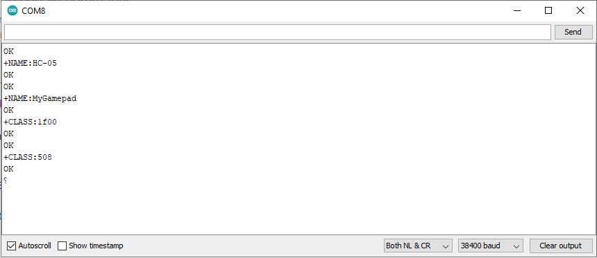

Posted at 2020-08-25 by user117205 I have been playing around with the AT commands of HC-05 recently. Here's what I have found, ->AT+CLASS? This will show HC-05 as an INPUT device(GAMEPAD) on your system. We are able to pair to the gamepad but not connect to it. ->AT+ROLE? where, 0 is for slave, 1 for master, 2 for slave-loop Attachments: |
