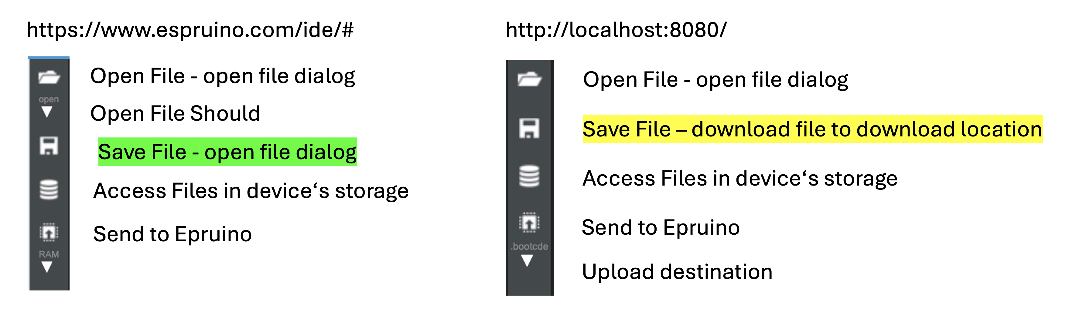

Posted at 2025-01-27 by @MaBecker Maybe a picture helpsAttachments: |
Posted at 2025-01-28 by @gfwilliams but when you click 'Save File' on the localhost version, you still get a dialog to save the file? Just as a download. Or is that broken? |
Posted at 2025-01-28 by @MaBecker No dialog, just download. Edit: add screen shots click on "Save File"
Posted at 2025-01-28 by @fanoush That is related to setting both in Chrome and Firefox - ask where to download files? By default it is turned off. Just checked and in Chrome it is in Settings -> Downloads -> Ask where to save each file before downloading |
Posted at 2025-01-29 by @gfwilliams Thanks @fanoush! Explains why it worked for me I guess. I don't think there's anything further than can be done with the IDE when running this way - it's all the web browser will let us do |
