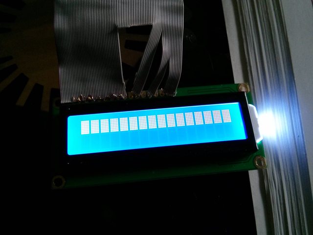

Posted at 2014-03-25 by @gfwilliams I reckon something's wrong with your wiring, because pin A11 isn't even on a pin header :) http://www.espruino.com/ReferenceESPRUINOBOARD You should be able to use any pins though - although try not to use the 3 that are also used for the LEDs. The block of pixels happens when the display powers on - so it could be anything (but at least you know the display is working). I just tried again here, and it still works fine (and I tried on a few different sets of pins). I'll update the docs, but these are the connections/code I'm using:

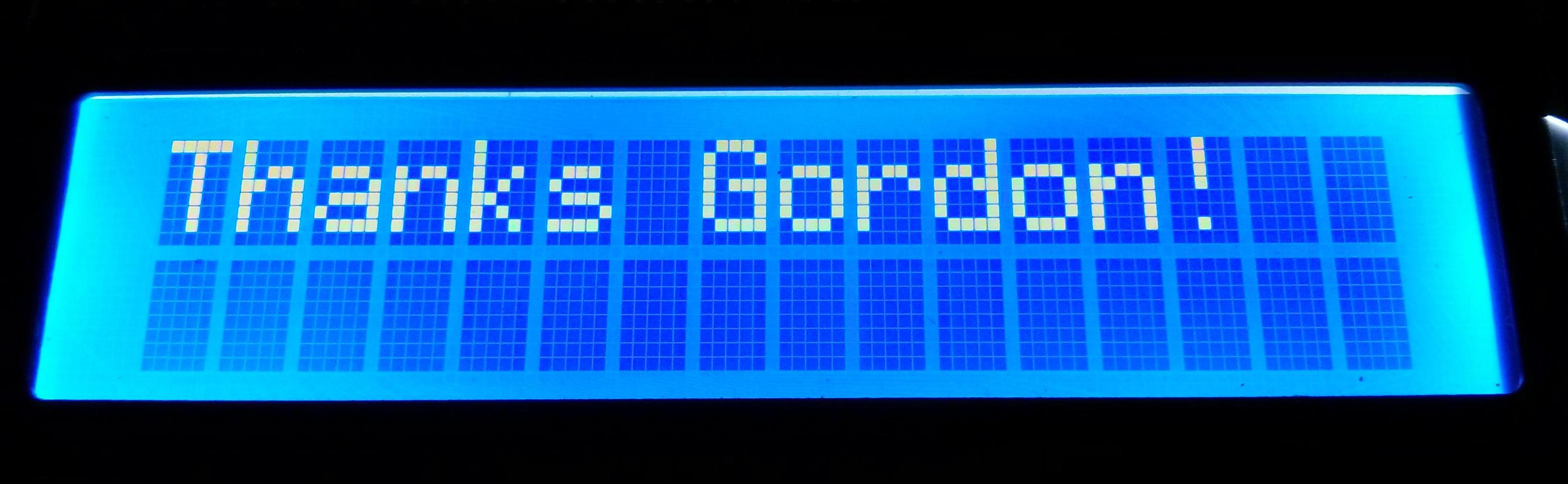

Posted at 2014-03-26 by @gfwilliams Great! :) What was it in the end? the RW line? |
Posted at 2014-03-26 by Owen It was my mysterious A11 pin wiring, the C pins work perfect. |
Posted at 2014-02-15 by Owen
Hi guys,
I've got a HD44780 LCD character Display Module and I'm trying to get it working with Espruino. I've followed the guide here http://www.espruino.com/HD44780 and installed the HD33780 module, but whenever I run the code I get the following error:
Do you have any idea what's going wrong here? I've tried writing the module code directly but I get much the same results. What should I try next to fix this?
Thanks
