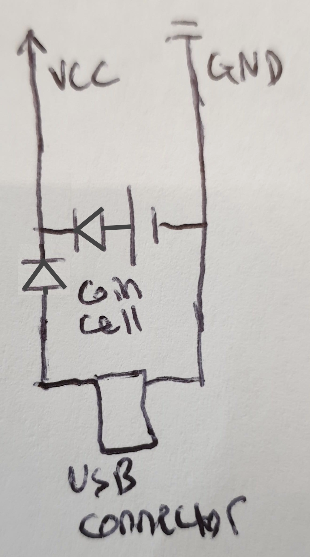

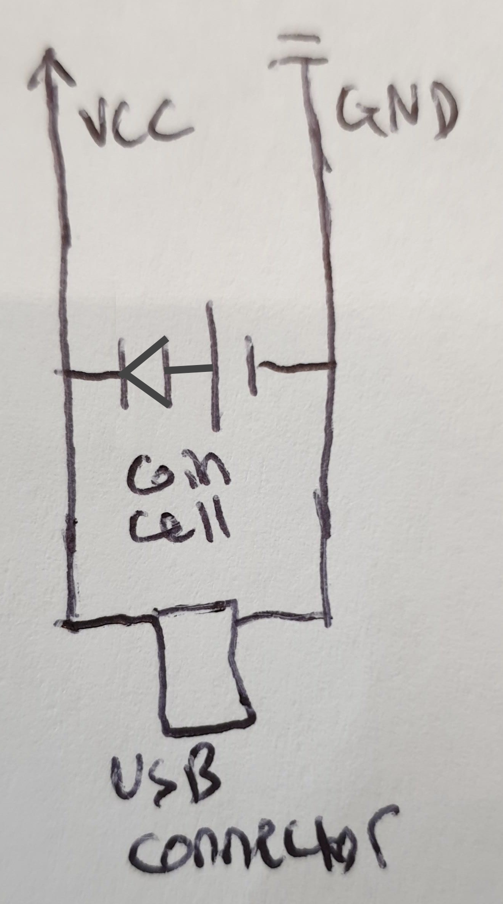

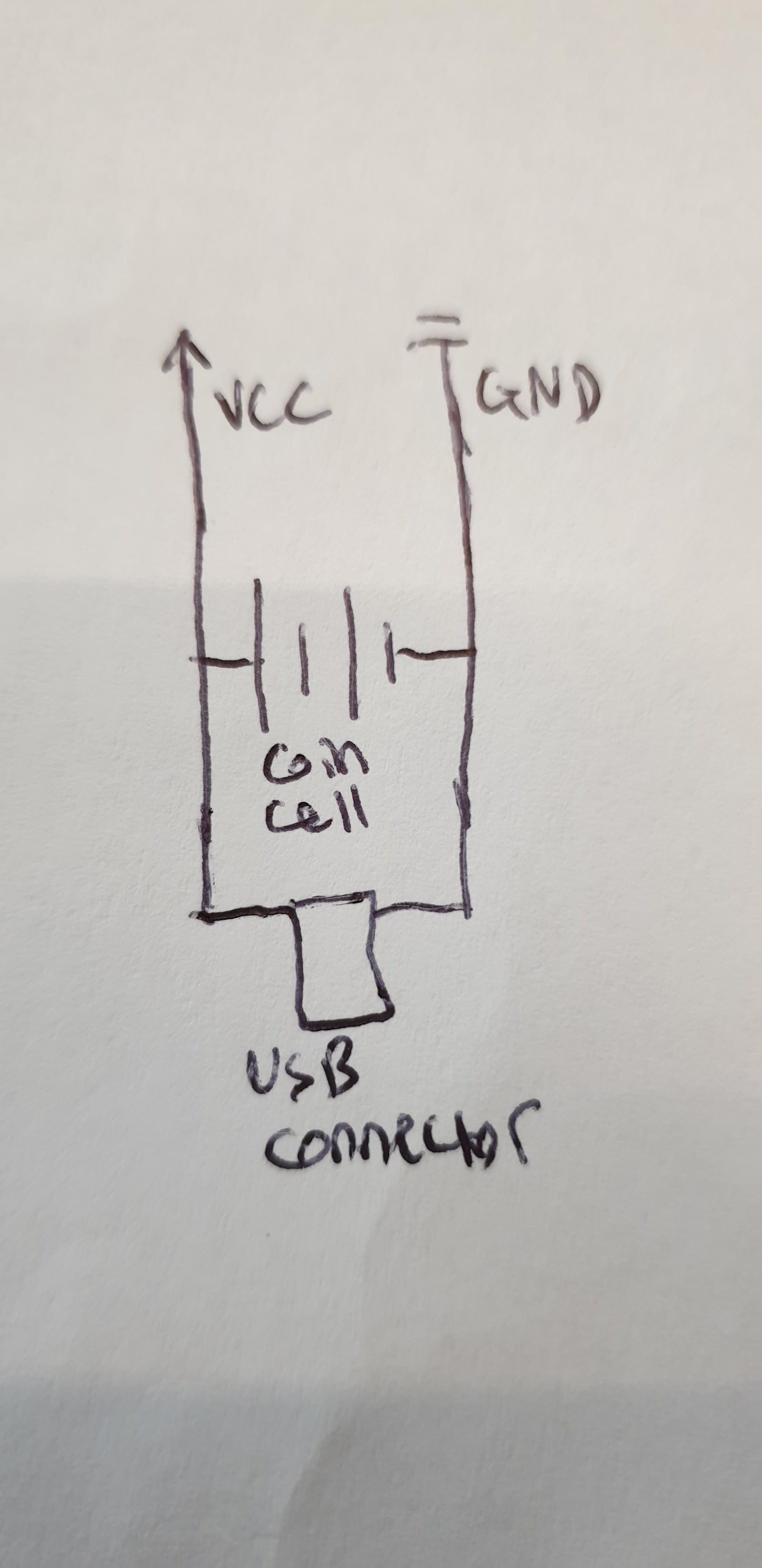

Posted at 2019-07-02 by @allObjects ...not really... you will destroy your button cell... but something like below will work:Attachments: |
Posted at 2019-07-02 by BootySnorkeler Thanks, and nice editing! |
Posted at 2019-07-02 by @allObjects Lowest forward bias is best... a good schottky does well. And yes, this is perfect protection. You have just to know that your module has |
Sorry, but can you clarify that in layman's terms for me please? |
Posted at 2019-07-02 by @allObjects Diodes have a behavior like this: you run them in reverse, they block. Your run them in forward mode, they let the power pass but Attachments: |
Posted at 2019-07-02 by @gfwilliams Are you talking about the MDBT42 breakout rather than a bare module? https://www.espruino.com/MDBT42Q Just checking since the breakout will be fine off 5v as it has a regulator (as long as you use the Vin pin, not 3.3v!) https://www.espruino.com/MDBT42Q#pinout, but the module won't be, since it'll take only 3.6v maximum. But as @allObjects says you just need some diodes in there. I'm not sure he was totally explicit about this but Schottky diodes are best for what you want since they lose smaller amounts of voltage (~0.3v vs ~0.7v for normal diodes) - while that doesn't matter for USB, the less voltage you can lose from the coin cell the better as it means more battery life. |
Posted at 2019-07-03 by BootySnorkeler Hey @gfwilliams and @allObjects, I bought 1N4007 diodes, the shop didn't have any schottky diodes. Will the LEDs be fine if I use a schottky diode? Thanks. |
Posted at 2019-07-03 by AkosLukacs With a regular diode like 1N4007, you have about 0.6-0.7V voltage drop. So with a 3V coin cell you have ~2.3V for the LEDs, with a schottky you would have ~2.7V. What color LEDs do you have? (forward voltage depends on color). Do you have any current limiting resistors for the LEDs? Maybe you can can change the current limiting resistors to lower value ones. But do the maths, so you don't burn the LEDs if you power it from 3.3v |

Posted at 2019-07-03 by @gfwilliams A Schottky diode would be better, but it may not be good enough. The differences in brightness are what you'd expect given the different voltages I'm afraid. If you're not tied to using a coin cell then you could instead use a LiPo battery - those supply 3.7v(ish) and would provide enough voltage to keep 3.3v on the microcontroller most of the time - plus they are rechargeable :) As @maze1980 points out, the diodes aren't the best way to do things, but they are easy! Another thing I do with the Original and Pico boards is the circuit shown here: https://www.espruino.com/Original#power Looks compilicated but you only care about the left-hand half. Basically you use a diode for USB where you have enough voltage to spare, and then you use a PFET (a p-channel field effect transistor) across the battery that is controlled from USB power. That way when there's no USB power the battery is used, and when there is, the battery is disconnected and everything is powered through the diode. |
Hey what's up,
Will I hurt my MDBT42Q module by connecting a coin cell battery in parallel with a USB jack(or any other connector really, like a JST) for optional external power? Will it hurt the battery? I've attached a simple diagram to further clarify what I mean.
The coin cell is a 3V CR1225 cell and the external power connector will be a similar 3.3v power source.
EDIT: the external power connector will also handle data transfer through the RX/TX lines.
