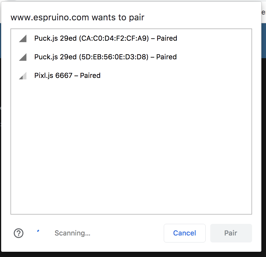

Posted at 2019-07-17 by @gfwilliams Very odd - yeah, it'd be good to catch up at JSOxford. If I'm honest I'm not sure if I'd be able to be much help with the Puck apart from to test it on my devices here and check it really is properly clear. It does sound like something's gone a bit strange with the iMac's (or Chrome's?) bluetooth info. If you power off the Puck and then search using Web Bluetooth, are those 2 devices with the different Mac addresses still shown? |

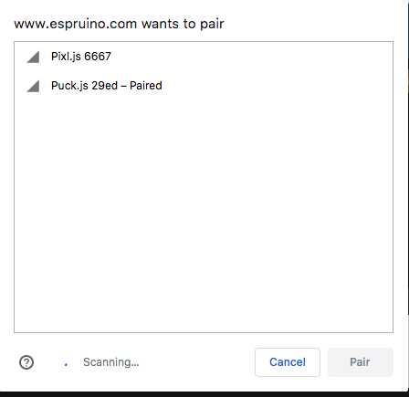

Got a slightly weird problem, dig out one of my pucks as I have a project idea, trying to connect it to my iMac to use the web IDE but when I scan for webbluetooth devices it sees the same puck name twice (with different ?MAC? addresses?
No matter which one I select it fails to connect
I've tried updating the fw to 2.04 and doing a hard reset neither of which helped.
I can connect my pixl to the iMac fine
I can connect this puck to my Macbook fine (it only shows up once there)
See screenshots for the details,
I'm a bit lost!
