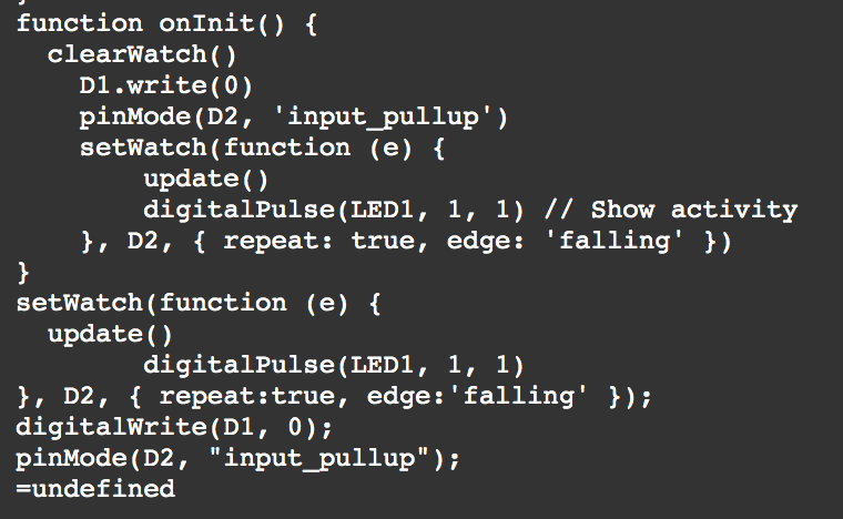

Posted at 2019-08-02 by @gfwilliams Can you post your code for the Puck up since it sounds like you've modified the code on it a bit? What happens if you use the unmodified original code for the tutorial? Does that work? I'm using it here and it's been running for a month or more just fine. One thing that could be an issue is you're calling |
Posted at 2019-08-02 by @gfwilliams Just to add: the setWatch could still be there - you can type One option is that you may be getting an error before the watch completes. For example: works fine, but if you'd called |
Posted at 2019-08-02 by Fisu You're correct that the original code did work without issue. Thanks for the suggestion about nesting The current Puck code is as follows: When I type Regarding your comment about an error in |
Posted at 2019-08-02 by Fisu @gfwilliams actually I was mistaken in the last message. When I check the |
Posted at 2019-08-02 by Fisu @gfwilliams This is what the end of the
Posted at 2019-08-05 by @gfwilliams Hi - that's what you'd expect - so what happens is So that all looks good. What happens if you're connected via Bluetooth when the LED flashes? Do you get any error messages? You could try putting ... or maybe: That'll flash green if it's ok, red if there was an error. Could you check

Posted at 2019-08-10 by Fisu I was so sure it was the battery that's the issue as it was working for 4-5 days without issue. Then last night (still with the new battery) it stopped working again. So whilst it is broken, when the light on the electric meter flashes, I don't get any light flashing on the Puck (I did implement the try/catch above, but neither the red nor green light flashes). I get no error messages when connected in the IDE. I wondered could it have something to do with the memory slots, but doing Would you happen to have any other ideas what I could try? |
Posted at 2019-08-10 by Robin Sat 2019.08.10 So that you are not waiting, wondering, Did you catch this post? I'm not able to assist as we don't have that type of meter here in the US. However, have you attempted to go back to the original source that Gordon references in #4 and give that a go? Are you able to restart and continue, e.g. this is only a run time issue after a period of time, or are you forced to reboot/re-upload? Is it possible there is a counter or something related to the date that reaches an upper limit, then causes an over flow or error? Could placing that section inside a try/catch help in identifying a possible cause to investigate further?
I've recreated and adapted the Smart meter tutorial. What I've noticed is, after I upload the code to the Puck, it watches the flashes correctly and will continue until I connect from the web page. From that moment on, it is as if the watch on the pin is removed. The Puck no longer flashes when the electric meter flashes, and there are no further records of the flashes. The variables stored in the Puck remain and are not reset, it seems it is just the watch method which has an issue after connection from the web page.
I'm not sure how to debug this issue. The only place
clearWatch()is called is in theonInit()function on the Puck. The connection code from the web page seems simple, and I cannot see anywhere there that might clear the watch. Any ideas on how I can further debug this issue?Here is the code from the website connection script (I don't call any Puck functions anywhere else apart from here):
