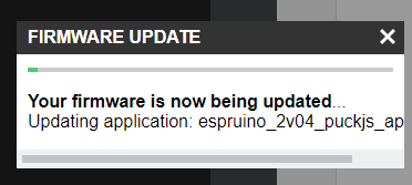

Posted at 2019-10-08 by AkosLukacs Something is not right with the Web Ide: Tried to update my new Puck, update started, but nothing happened for several minutes. Tried it 3 times, no luck (last time I waited for 5 minutes). But I could connect to the puck every time. One thing seems to be off: The web Ide was displaying After that I just used nRF Connect on my phone, and updated just fine, and works just fine. Oh, and 1 more confusing thing: Pico firmware update with the Web Ide asks me to choose from a firmware with either WIZNet W5500 or TI CC3000 networking. There is no "I don't want networking" option. So I just did a "Advanced Firmware Update" from the Web IDE with https://www.espruino.com/binaries/travis/master/espruino_2v04_pico_1r3.bin and worked just fine. |
Posted at 2019-10-08 by @gfwilliams

Posted at 2019-10-08 by AkosLukacs Puck -> tried it with Chrome, and same behaviour: that green progress bar is stuck, and doesn't go anywhere. (screenshot is taken after waiting a couple of minutes) Reboot, and back to previously flashed firmware. Pico -> Ah, OK. I did update it, so no problem there. What was confusing is the download page https://www.espruino.com/Download lists firmwares with WIZnet and TI CC3000. But the latest master build https://www.espruino.com/binaries/travis/master/ doesn't have either.Attachments: |

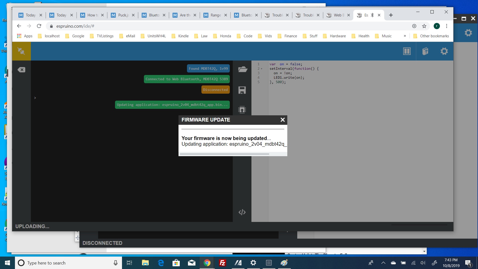

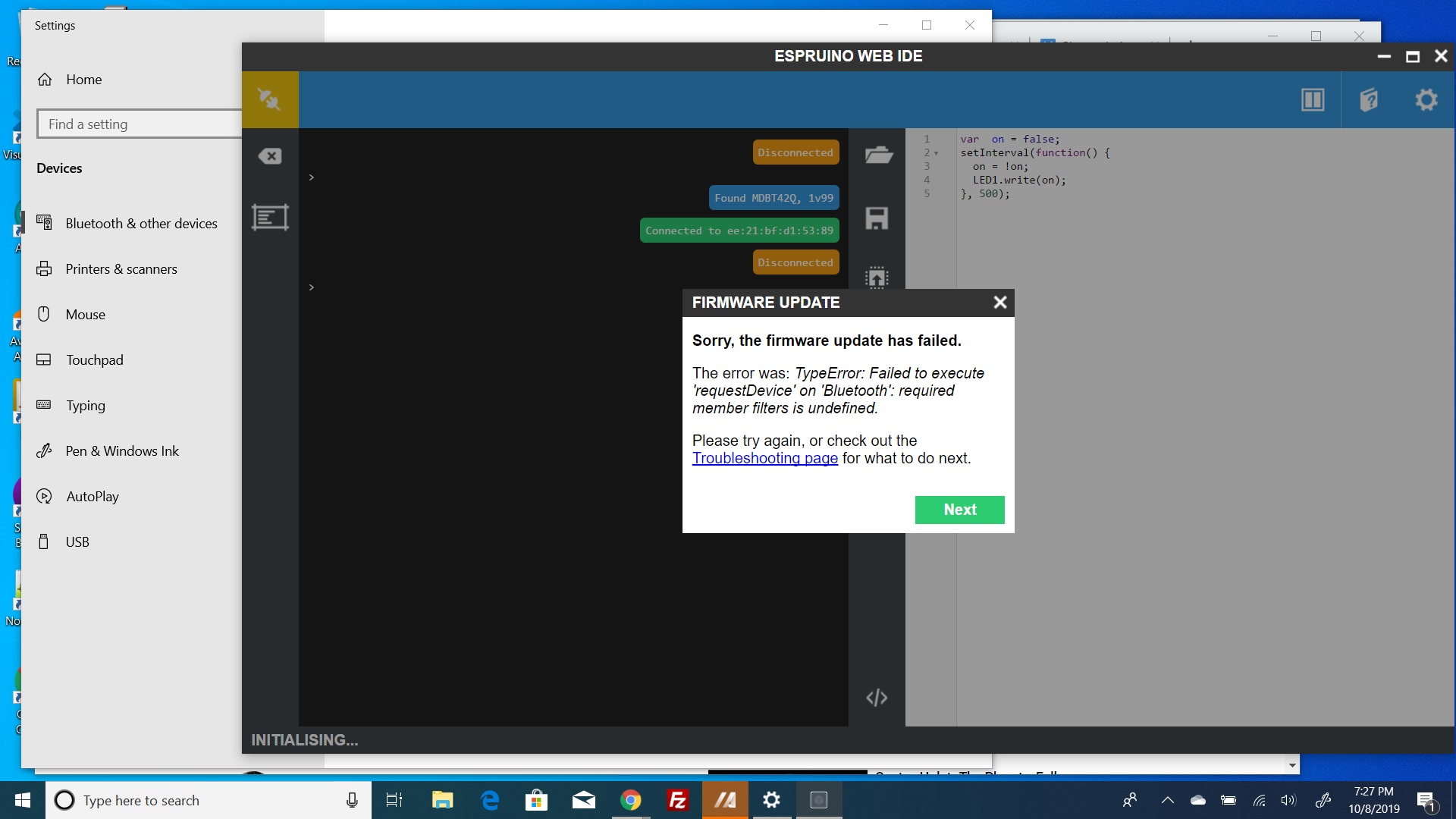

Posted at 2019-10-09 by Robin Tue 2019.10.08 Not sure this is directly related, but had the same stuck bar three weeks ago attempting to update a MDBT42Q. After three attempts abandoned, also didn't post. Then I caught the above thread. Decided to give it another go. This time however, I get a unique new msg. Didn't try more than three times, lacking time. If this is related to the above, I hope it provides some insight. If not, I'll create a new thread if necessary. Using the Native WebIDE on Windows10 Strangely had to constantly un-pair and allow a new power up/pair sequence and relaunch of the WebIDE to even connect. EDIT: Just tried with Chrome using https://www.espruino.com/ide/# and thought I had success, until . . . but get the same stuck bar.

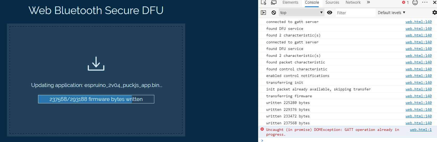

Posted at 2019-10-09 by AkosLukacs Yes, connected to "DfuTarg", the LED changed immediately, but stuck there forever. Like Robin's second screenshot. But I had no issue like him with connecting and pairing. It was straight forward up to the last point. But: Tried to capture traffic with nRF sniffer, of course failed to capture on the first try :) But Chrome started uploading. And then stopped at about 75% (and the "Software Reporter Tool" started eating my CPU). Eventually killed Chrome, and the Puck was working after a reboot. I don't know if the update succeeded, just the progress bar didn't update. Or what's going on. AFAIK, there is no OTA recovery partition in the Puck, right? |
Posted at 2019-10-09 by @gfwilliams First error is because Robin is using the Native IDE on a computer without Web Bluetooth - the library I made to handle BLE communications only handles UART, not DFU. I've filed a bug to disable the Web IDE update option in that case.

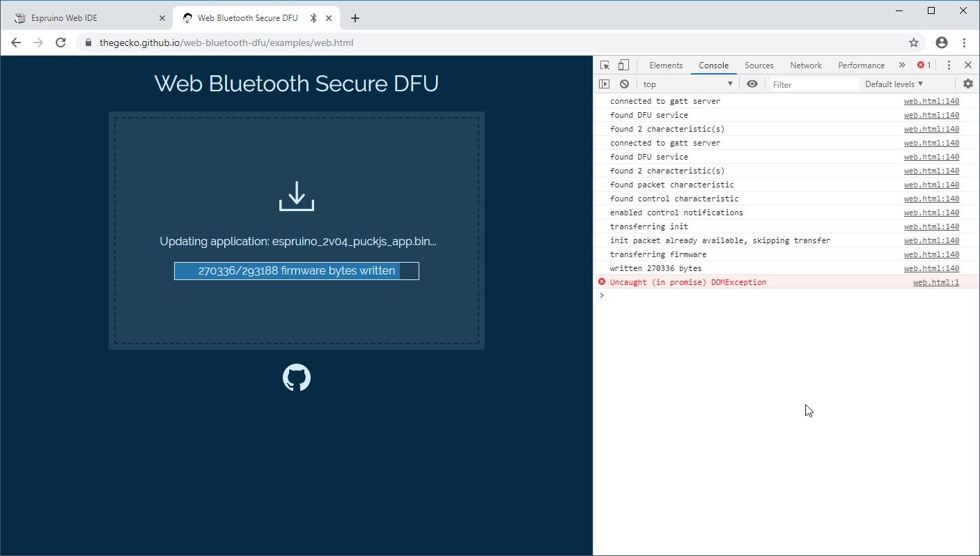

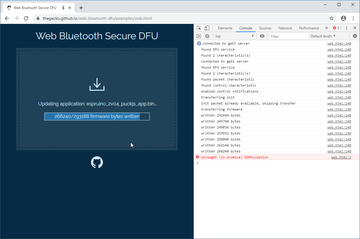

It'd be great if you could see what was going on with the sniffer. I guess it's possible that the windows Web Bluetooth implementation doesn't properly yield to the OS, and it could be fixed by adding some timeouts. Does this work for you? https://thegecko.github.io/web-bluetooth-dfu/examples/web.html If so I might just be able to update the DFU implementation. |
Posted at 2019-10-09 by AkosLukacs Something is not right with that too: did progress up to a point, opening the console revealed an exception (screenshots attached). Tried it in Edge and Chrome, same behaviour. But looks like the link you sent continues the DFU from the previous fail point.
