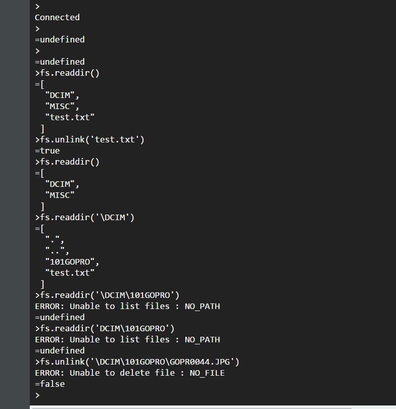

Posted at 2014-11-26 by @gfwilliams Hi - I think it may just be that you're using the wrong type of slash (and I'm not sure you need the first one either)... Try |
Posted at 2014-11-26 by Hellis Wow! But you are correct! it was the slash Thanks! |
How do I browse subfolders and unlink files in subfolders?
The picture shows how I can read the root and first subfolder, but not the second subfolder.
And I can delete a file in the root but I can't delete them in subfolders.
What am I doing wrong?
