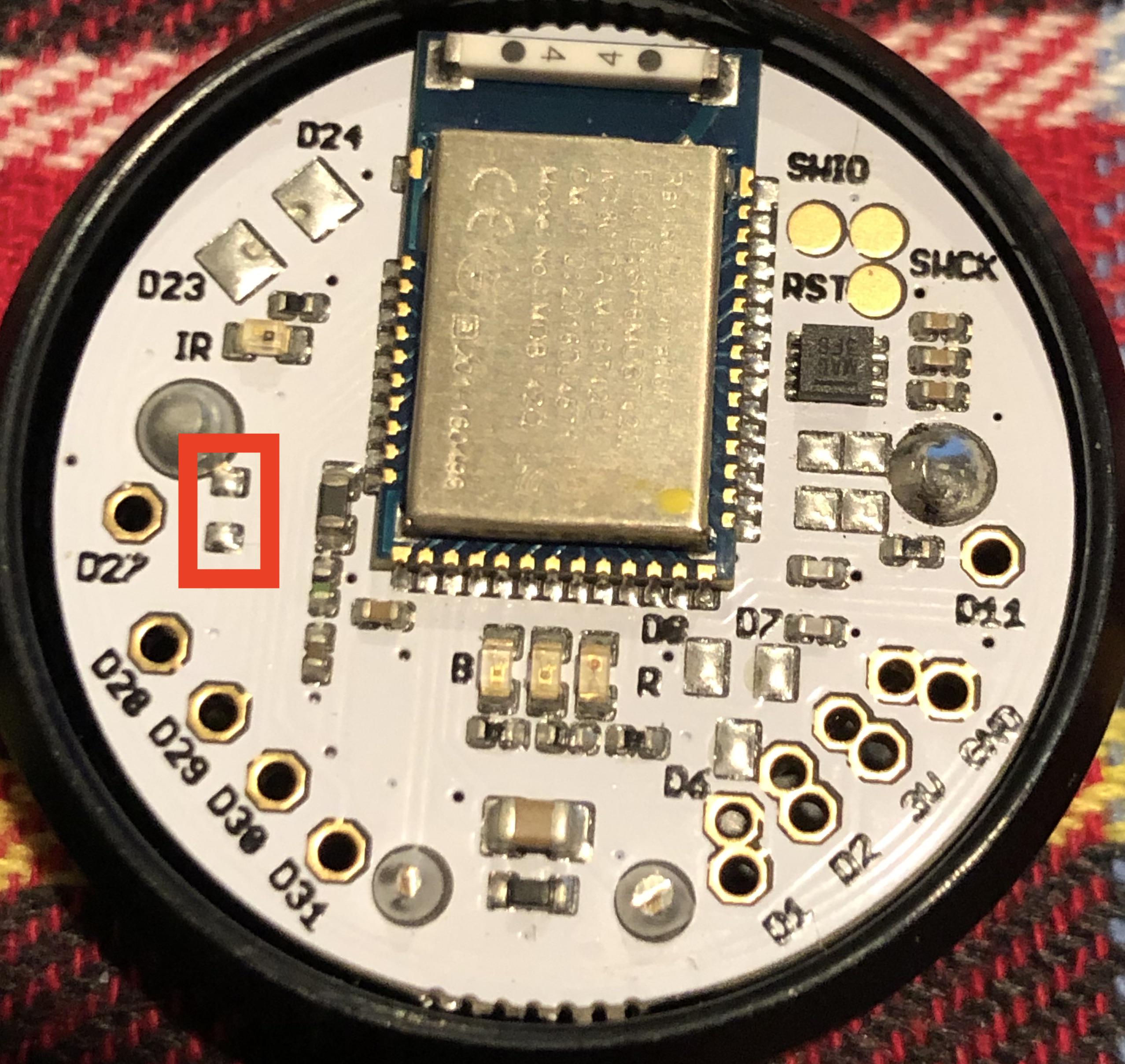

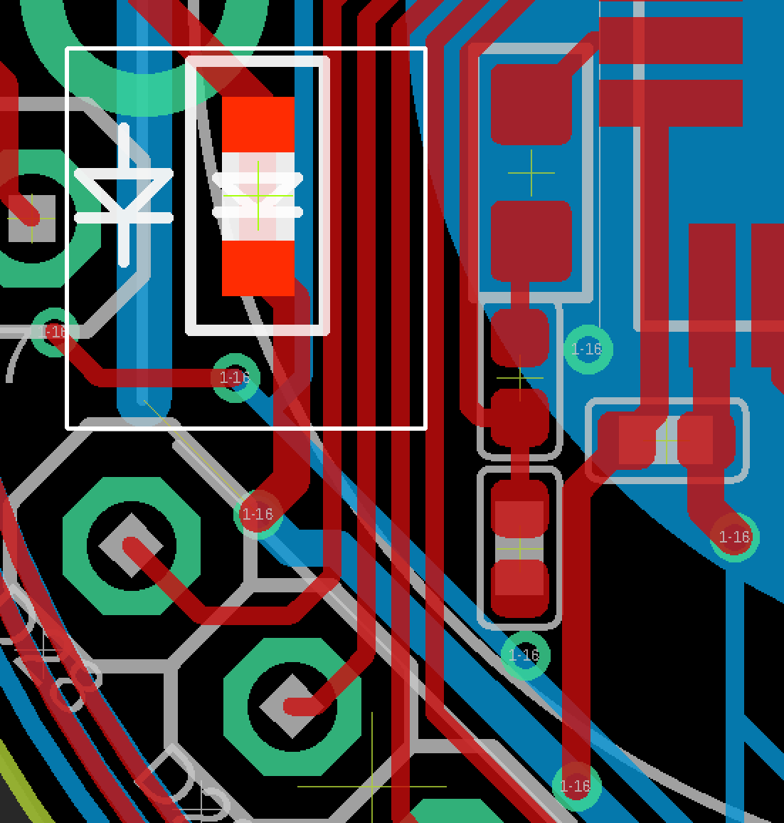

Posted at 2020-03-23 by dandelany I haven't made this mod myself (yet), but was considering it & also read the threads you link to above. I opened the board schematic/layout in Eagle & I think I've figured it out. The confusion is from the fact that there are two different things called D7 - the diode part name in the Eagle file is "D7", whereas the pad you're looking at is the GPIO pin called "D7", but they are actually unrelated. It appears to me that Diode D7 is meant to be soldered to the two pads on the left side of the board, near the D27 pin - see the attached photo. In Eagle, these two pads are connected, so "cut the trace" presumably means the trace directly underneath the area between these two pads (being extremely careful not to cut the nearby traces to D28-31). Hopefully Gordon can chime in and correct me if I'm wrong :) Edit to add: re: orientation, the part symbol in Eagle shows the cathode (-) pointing down (towards the row of D28-31 pins)Attachments: |

Posted at 2020-03-23 by @gfwilliams @dandelany spot on - yes, that's exactly where you need to cut and put the diode. Just a note that the Puck.js v2 won't have the space for a diode - it never really seemed like it got used. However if you want to use a CR2032 adaptor, 2x AAs, or a LiFePo4 battery would be perfect |

Posted at 2020-03-23 by Robin
Sun 2020.03.22
Puck landing page indicates: 'based on a normal CR2032 battery'
A standard (normal) Lithium Manganese Dioxide (LiMn02) is 3V nominal with a capaity of 210-230 mAh
Although much lower capacity, LiR2032 battery is 3.6 V battery, with typical capacity in 50-70 mAh range and may be charged 500+ times. (lithium cobalt oxide, lithium manganese oxide, lithium iron phosphate, lithium nickel cobalt aluminum oxide - range 3V2 - 3V9)
Note on schematic indicates Diode at D7
see lower left
https://github.com/espruino/EspruinoBoard/blob/master/Puck.js/pdf/puckjs_sch.pdf
with note 'allow LiPo 2032s to be used if diode in here'
Instruction indicate to cut trace: 'If you cut the trace and solder a diode in, that'll drop the voltage enough that you can use a LiPo.'
I've stared at layout and Puck itself and have located D7
but it isn't clear where the trace to cut is. It looks like the diode should be soldered between D7 - D8, but unsure of that also, but no trace between the two. (could it be on the back side of the board? - not easily accessible)
A diagram would really help here and maybe a photo if someone has made the mod.
