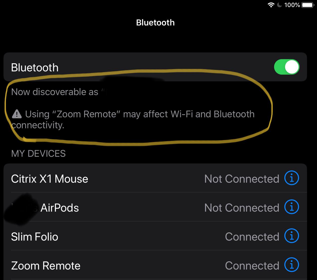

Posted at 2020-03-30 by Neil_ Thank you Gordon for your response, Apologies JS is relatively new to me, but your tip on just using MODIFY was just what was needed, once i figured out how to concatenate the keys it worked liked a charm for me. I have one remaining issue in that my iPad now warns me in bluetooth settings, when the Puck is connected to it, I'm guess its not a recognised bluetooth vendor ID or something? Error on iPad Very pleased with the Puck.js have many more ideas for it! Many thanks |
Posted at 2020-03-31 by @gfwilliams
Wow, that's new! Do you have a screenshot? I have a feeling that may be Apple's way of saying: "this device manufacturer hasn't paid us to be iOS certified" |
Posted at 2020-03-31 by Neil_ Hi Gordon, I've attached the screen shot from my iPad plus my code in case anything might be causing it in there! I have tried playing with the NRF.setServices values to see if it makes any difference but still the same result. Many Thanks
Posted at 2020-04-01 by @gfwilliams Thanks! What you're doing sounds perfectly fine. I guess you tried without the magic Apple service? Only thing I can think is maybe it's complaining about the connection interval? Espruino uses a fast connection interval normally and drops down after 1-2 minutes of inactivity. You could force it to use a lower connection interval with something like |
