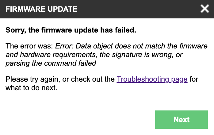

Posted at 2020-04-28 by @gfwilliams Wow, that's a new one! Please could you try updating with nRF connect on your phone? http://www.espruino.com/MDBT42Q#firmware-updates I imagine that'll solve the issue for you. I'm still not sure why but it does seem that the IDE's bluetooth firmware updater can be a bit unreliable on some platforms. |
Posted at 2020-04-28 by user97106 Yes, I was suprised as well, as previously doing lots of work with these including updating firmware and I've had to problems. Hmm, now I think about it and based on your comment, I may have done the update previously on a Winbows box, not Mac. Might try that as well. I'll also try your suggestion later today. |
Posted at 2020-04-28 by user97106 Ah, ha. Works fine using my Windows 10 machine. In fact, it did fail once with the same error but a lot further along in the process. Next try was successful. Mac fails almost immediately. So for information, I see this issue on a Macbook Pro running Catalina, Version 10.15.4. |
Posted at 2020-04-28 by @gfwilliams Thanks! So much for web stuff behaving the same in different OSes :) |

Posted at 2020-04-27 by user97106
Hi All,
I come back to my MDBT42Q project after quite a few months break.
I attempted to update to the latest firmeware but I seemed to have bricked both the MDBT42Q modules I have. I'm using the Web IDE and it seems to go fine but immediately return with this error...
"Sorry, the firmeare update has failed.
The rror was: Error: Data object does not match the firmware and hardware requirements, the signature is wrong, or the parsing command failed"
I've attached a screen shot.
Note, they connected fine before I tried to flash them. I'm sure I must be doing something silly.
Anyone know how to recover from this.
By the way, I'm on Mac, in case that matter.
Regards,
Marco
