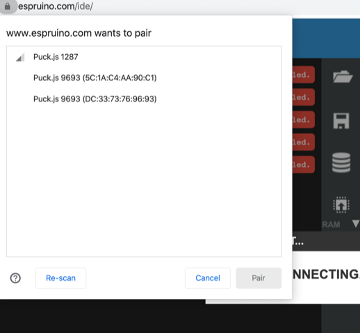

Posted at 2020-04-28 by user106712 I used another computer and managed to see two entries (9663). I did not pair then. I returned to the first computer and was able to find the Puck and pair with it. Solved. Thanks! But why the two entries? Attachments: |
Posted at 2020-04-28 by @gfwilliams
Is it possible you'd tried using |
Posted at 2020-04-29 by user106712 Not as far as I know. Both Pucks now behave well. Thanks. |
