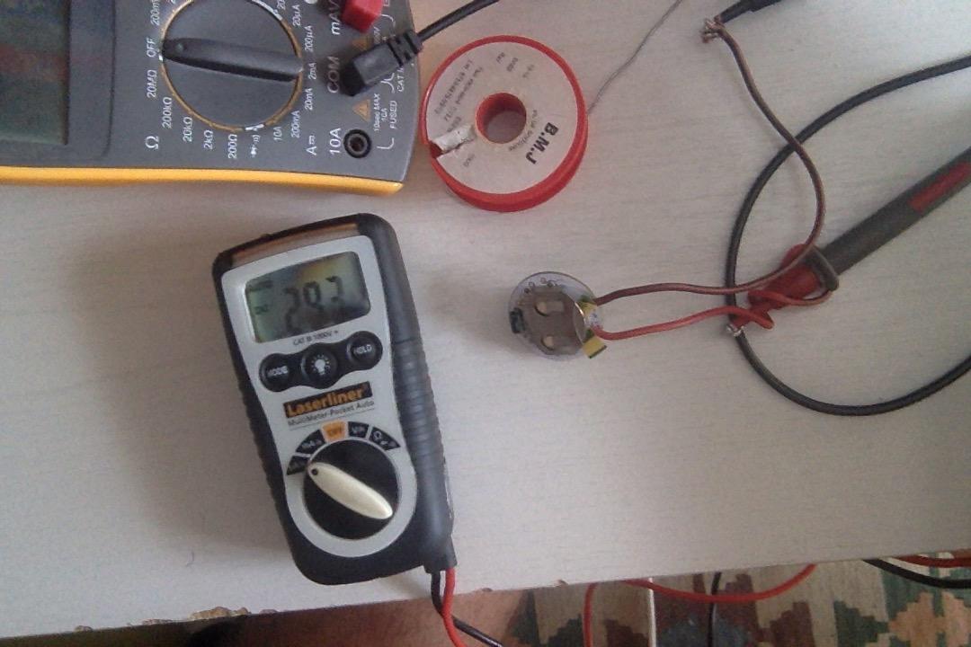

Posted at 2020-05-09 by user111953 Hi Gordon, For my part I don' t manage to get under 290uA... My measurements are taken with a small amperemeter. It connects the negative pole of the battery to the ground of the circuit. (A piece of plastic separates them, so the ciruit is off if my amperemeter is off). Any idea ?Attachments: |
Posted at 2020-05-09 by user111953 After a hard reset I get ±32uA. I don't know why current intensity was so high the first time. I manage to get ±25 uA with stopping BLE. I flashed the puck with this simple code : It's far better but I still don't understand how I can get less than 5uA. |
Posted at 2020-05-11 by @gfwilliams Do you have up to date firmware? Do you have any pullup/pulldown on the reed switch pin? If the reed switch is normally closed that'd obviously cause power draw, but if it's normally open and there's no pullup then any electrical noise on the pin (or any other pins set as inputs) could cause activity inside the nRF52 which draws more power. ... but also if you look at http://www.espruino.com/Puck.js#power-consumption unfortunately just adding a watch to a pin to check its state can add around 10uA of power consumption. |
