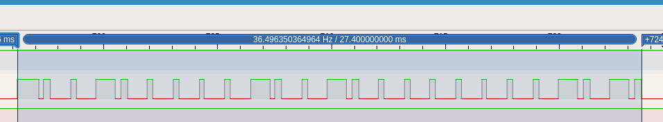

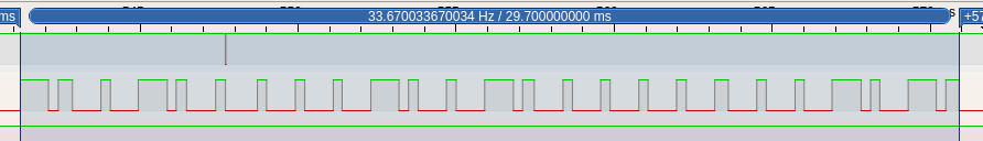

Posted at 2020-09-30 by @gniezen Using a logic analyser, the Pico pulse trains are 27.4ms long, pretty close to the 25 * 1.1ms = 27.5ms: The Pixl.js pulse trains are 29.7ms long: I used the remote control example code for both, just changing from A6 on the Pico to D13 on the Pixl.js, and modifying the pulse train sequences for my sockets. |
Posted at 2020-09-30 by @gfwilliams Please could you try: That might fix it - it's possible that because the Pixl is a bit slower than STM32 boards it's actually struggling to go around the loop and call digitalPulse again before all the pulses have already gone out? Sending them all in one go might sort it. |
Posted at 2020-09-30 by @gniezen Gave it a try, but the Pixl.js pulse train is still 29.7ms. |
