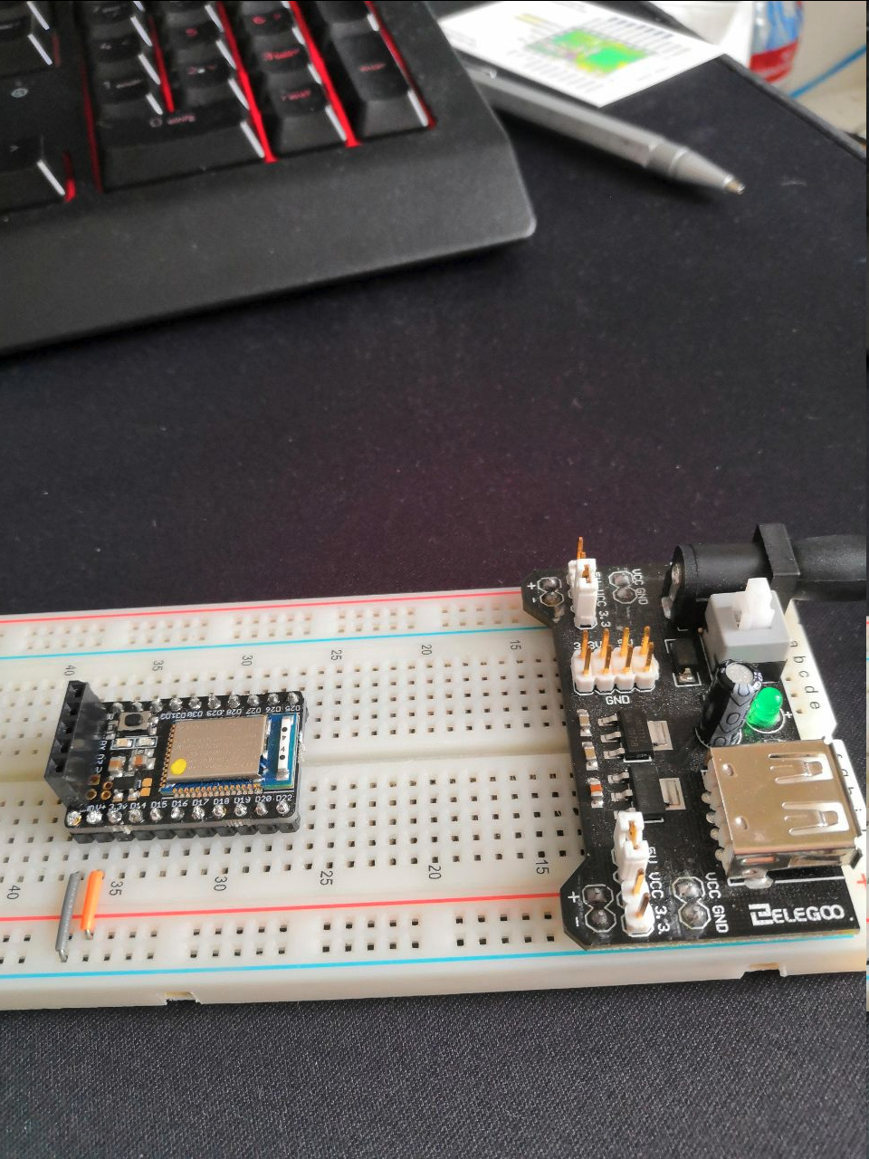

MDBT42Q maybe bricked after soldering #3661

Posted at 2021-02-15 by @gfwilliams Do you have a photo of it? Also, when you attach power to it, does the red led blink? Can you enter bootloader mode by holding the button while applying power? (the green LED should be on constantly in bootloader mode) |
Posted at 2021-02-15 by @gfwilliams Is it possible you might have accidentally connected the 3.3v power input on the module to 5v from the breadboard supply? If so that'd do the sort of thing you're experiencing - working for a bit and then breaking... |
Posted at 2021-02-15 by @fanoush you seem to have that right side power jumper connected to 5v side. it is 5v,gnd,gnd,3.3 so in the middle it is off, left two is 5v, right two is 3.3V |
Posted at 2021-02-16 by @allObjects It looks good to me when comparing with the reference on http://www.espruino.com/MDBT42Q page... What does not look so favorable to me is the shape and surface structure of the soldering points: somehow they look like having had a cold... no flow ;-) Mend the soldering points w/ fluxed tin that it flows, then try again. - I hope you did not - before - connect by accident the wrong way or some 'flailing' wires touched in unfavorable locations ;-)Attachments: |
Posted at 2021-02-16 by @fanoush As mentioned the power rail is fed from 5V so this might be the real issue. I have this breadboard power adapter too, it is nice that you can have both 3.3V and 5V on different sides of breadboard but it is easy to mix it.Attachments: |
Posted at 2021-02-16 by @fanoush Oh, sorry, maybe it is OK? I now see it is connected to the VIN pin and that one can accept 5V as there is voltage regulator on that MDBT42Q board. So please ignore my posts :-) |
Posted at 2021-02-16 by OmegaRogue I connected it to 5V after I wasn't getting much success with getting the MDBT42Q to connect over bluetooth or Serial, and i made sure to only use the VIN Pins to connect power, and made sure to not leave and cables flailing around |
Posted at 2021-02-16 by @gfwilliams Do you think you could check the voltage between GND and 3.3v on the MDBT42 breakout's pins with a volt meter? That'd help to narrow down if it's the voltage regulator on the module that is blown, or something else. Also, did you try just powering it up with the button held down to see if any lights light up? |
Posted at 2021-02-16 by OmegaRogue I'm measuring 2.4V between GND and 3.3V when i put my power adapter on 3.3V, and 2.7V when i put it on 5V, and I'm measuring 2.5V between GND and V of the power adapter when the MDBT42Q is disconnected, and 6.7V when it's on 5V with the MDBT42Q disconnected. I have a 9V 1.2A power supply connected to the power adapter. |
Posted at 2021-02-16 by @gfwilliams Ok, so with the MDBT42 connected, what do you measure between GND and Vin on the MDBT42? So the grey and orange wires. Or was that what you meant with 2.5v? If so it sounds like something is wrong with your power supply board. |
Posted at 2021-02-16 by OmegaRogue i measure 2.4V with 3.3V, and 6.3V with 5V between the GND and Vin pins on the MDBT42Q |
Posted at 2021-02-16 by OmegaRogue Before I soldered headers on to it, I wrapped wires through the holes in the PCB, and was able to somewhat use it with the same power adapter. |
I'm not sure I understand - so you're saying that the wires on your breadboard power supply that should supply 5v are actually supplying 6.3v? |
Posted at 2021-02-16 by OmegaRogue yes, and up to 6.7V when the MDBT52Q is disconnected, even though I'm supplying less power than the supply is rated for. |
Posted at 2021-02-16 by @gfwilliams This sounds really broken. It's hard to know if this matters or not with the supply you have, but is it possible that you've got a 9v AC supply plugged into it, when it is expecting a DC supply? |
Posted at 2021-02-16 by OmegaRogue I've never thought of that, but it turns out that it was an AC supply i had plugged into it the whole time |
Posted at 2021-02-16 by OmegaRogue with a DC supply, i get 3.3V correctly at all points, but 8V on 5V |
Posted at 2021-02-17 by @gfwilliams
It might be the voltage regulator on the power supply board has blown up then? You say you get 3.3v correctly - you mean you get 3.3v on the MDBT42 breakout's 3.3v wire as well? If it's not working now, I'm afraid it may well be blown up. If the power supply board wasn't meant for AC, and was outputting negative 9v straight into the MDBT42 breakout, there's no way it's meant to survive that kind of punishment. |
Posted at 2021-02-17 by @fanoush So if you are now sure 3.3V is working, you may try to connect it directly to 3.3 pin on the board and avoid voltage regulator on MDBT42 breakout? This was the way I initially thought you might be using, didn't notice you have 3.3V source but still use 5V via MDBT42 regulator instead. This might help if MDBT42 voltage regulator is not working but nrf52 is still OK. |
Posted at 2021-02-14 by OmegaRogue
I soldered headers onto my MDBT42Q from the BangleJs Kickstarter and flashed the latest firmware, after which I haven't been able to get it to connect to my PC anymore.
