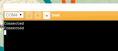

Posted at 2014-03-07 by mattbrailsford
Hi Guys,
I've just installed my HC-05 bluetooth module and was able to pair it with my computer (MBP running Windows 8 via bootcamp) however when I see it in the device list, it shows up as offline. Strangely, when I launch the Web IDE, the com ports show up, but when I try to connect, it says connected, but I can't do anything else (I can't type into the console or anything).
