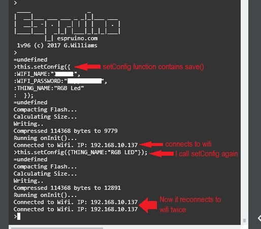

Posted at 2018-04-19 by @gfwilliams That's an odd one - just tried here with: then: And it seems to work... Could it be that in In that case, it'd be saving the current state (which is in the middle of a connection), but then Having said all that, saving the network details the way you're doing (re-saving all your code) isn't ideal. In 1v96 I added So now when you change your wifi details it modifies just the wifi details in a file called Posted at 2018-04-23 by Eyzi Hi Gordon! Thanks for the reply. My bad for not noticing the |
Posted at 2018-04-18 by Eyzi
Hello,
I'm having trouble removing the previous instance of the Wifi connection when I call the
save()function. (see attached image)I have a function
