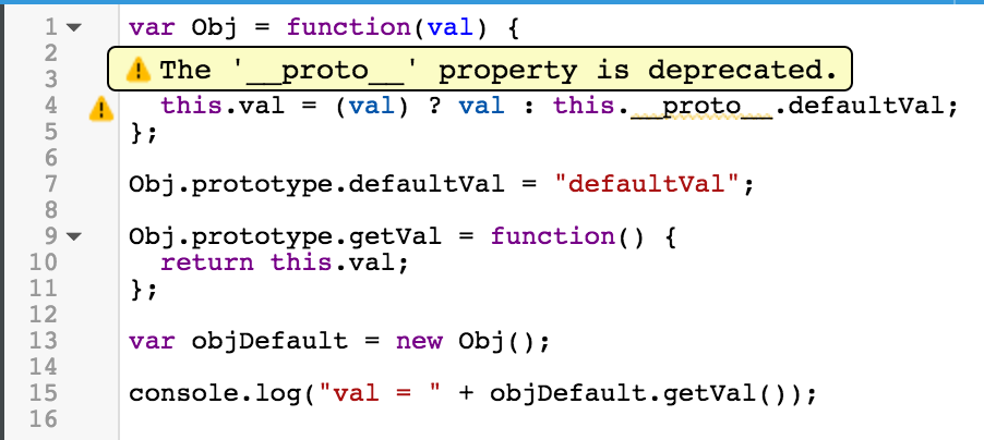

How come this.__proto__ being deprecated but Object.getPrototypeOf(this) not implemented? #564

Posted at 2016-05-06 by @gfwilliams This'll be the JSHint (the lint plugin for the Web IDE) picking up on something. |
Posted at 2016-05-06 by DrAzzy So it's just the linter bitching about Object.getPrototypeOf is not listed in the reference, so it's no surprise that it's not implemented (the reference list is exhaustive, right? I think it's autogenerated so all methodscd show up, even if there's no info on them). Edit: beaten.... |

@allObjects - https://github.com/espruino/EspruinoWebIDE/blob/gh-pages/js/core/editorJavaScript.js#L29 :) I'm not sure it needs to be configurable, but disabling just that warning should be easy. |
Posted at 2016-05-06 by @allObjects
Code using deprecated
__proto__
(see screenshot) works:Console output:
