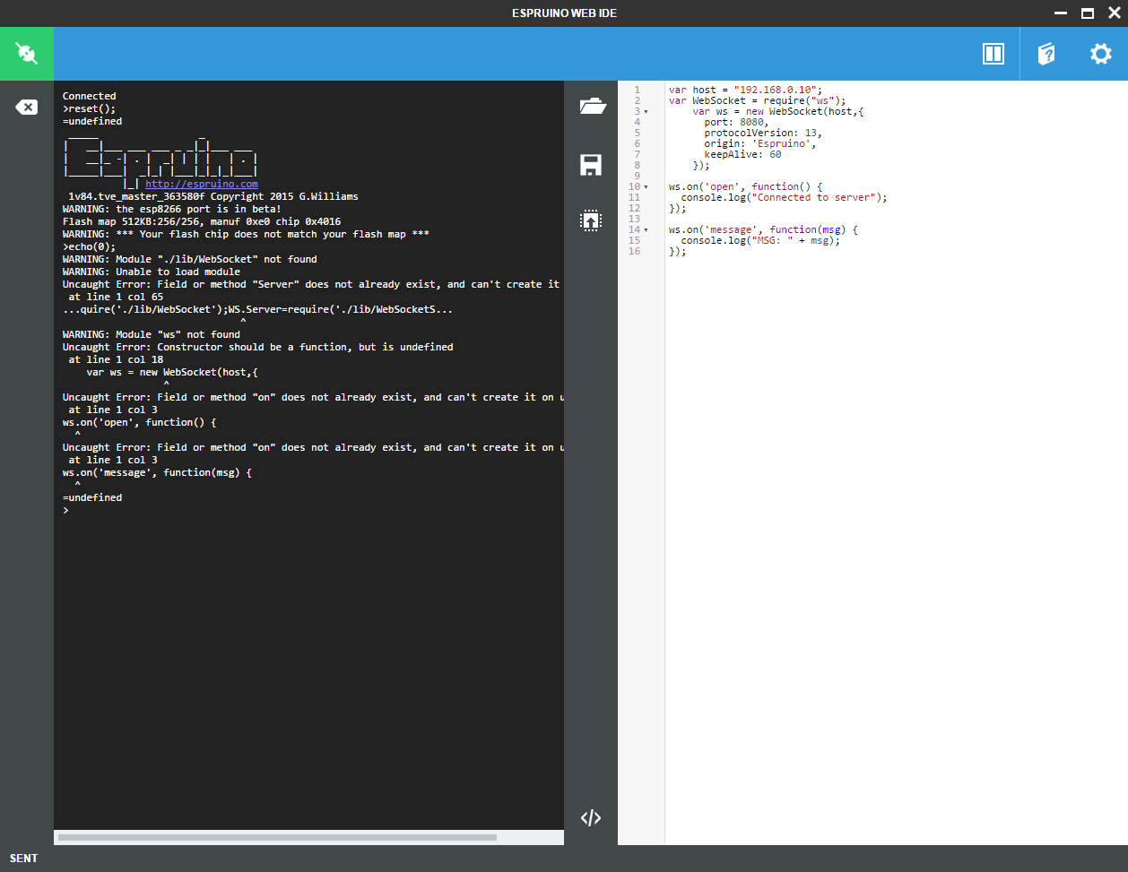

Posted at 2016-05-29 by Ollie Not sure about error but in short term you can require the module directly using a path to it's URI on espruino.com (or anywhere else), or download it and require it from disk. First approach v.simple:
Posted at 2016-05-30 by Wilberforce It looks like you have a local file called ws.js or ws.min.js and that is getting loaded rather than the espurino module. Did you make a project and put a ws file in the module folder? |
Posted at 2016-05-30 by Lorè Thank you now it work, i require all the path. So i can use also all node js library? |

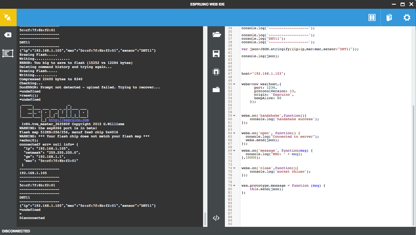

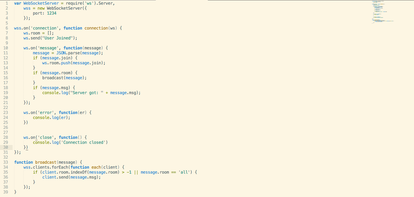

Posted at 2016-05-31 by Lorè ok, but now i have another problem with websocket. I don't know why when i try to connect with my nodejs server this call everytime the event 'connection closed'Attachments: |

Posted at 2016-06-01 by DrAzzy You have an old version of Espruino on your ESP8266 (and the wrong version for the flash chip you're using). I'd suggest flashing @tve's latest version - and make sure to select the correct version for the size flash chip that your ESP8266 has. I think at least one of the people who's active on the gitter channel has used websockets on the ESP8266 and might be able to point you in the right direction. I'd try that - a lot of the ESP8266 people use the gitter channel. |
Posted at 2016-05-29 by Lorè
I reiceve the errors in photo i don't know why because in http://www.espruino.com/modules there is a ws library.
I use a nodemcu dev kit board.
Thanks in advance
