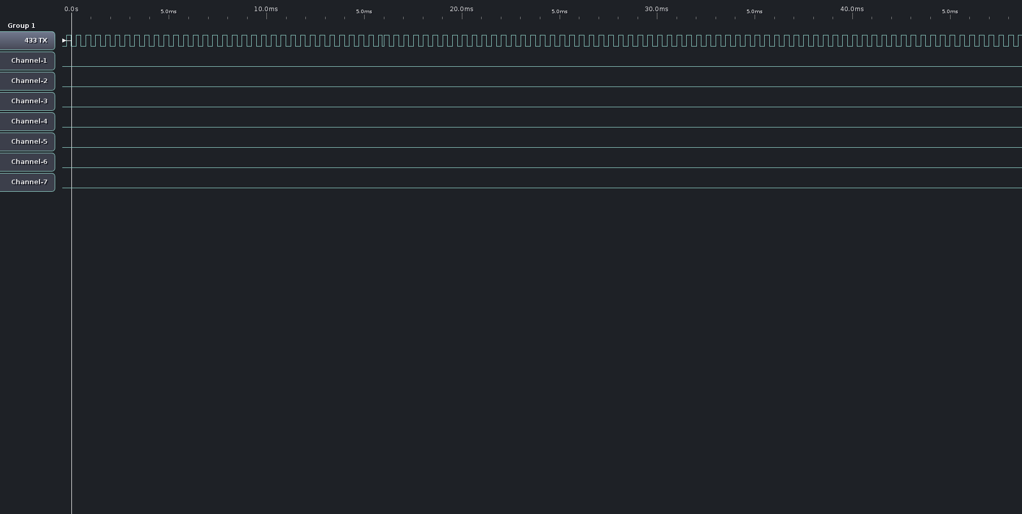

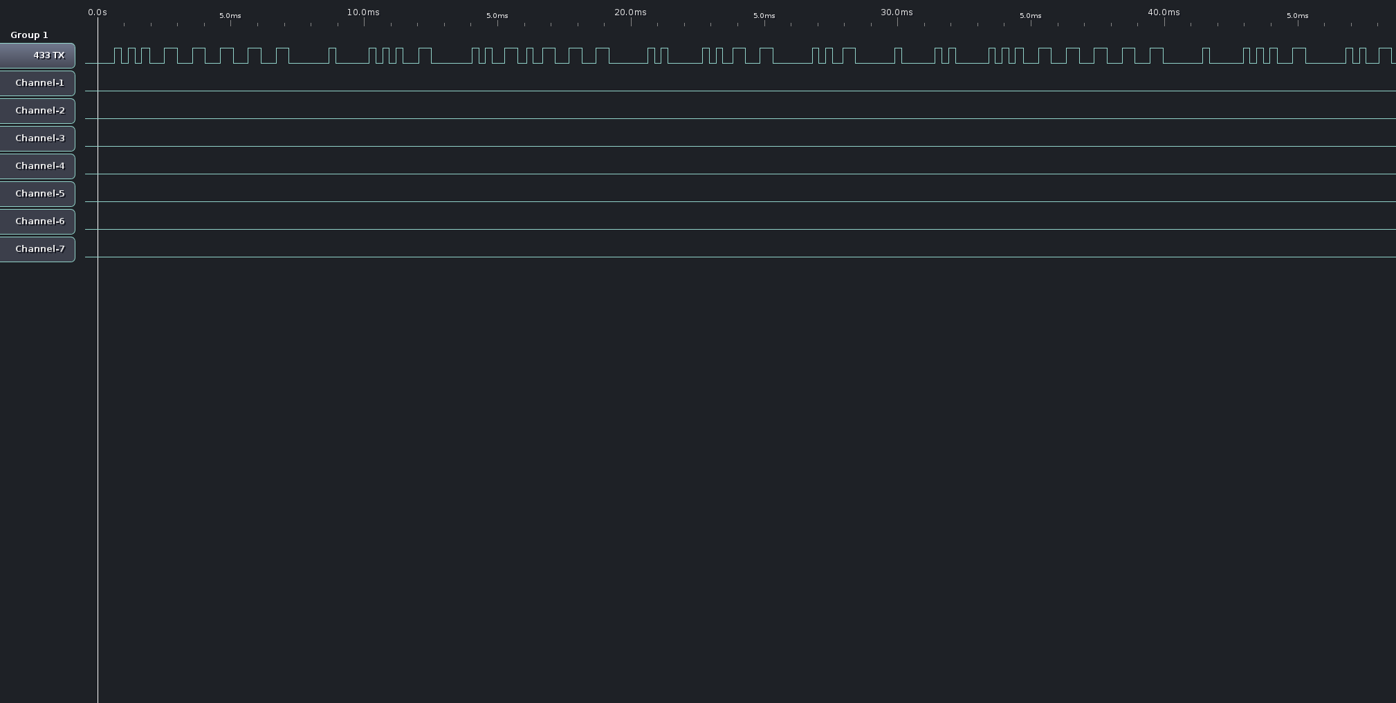

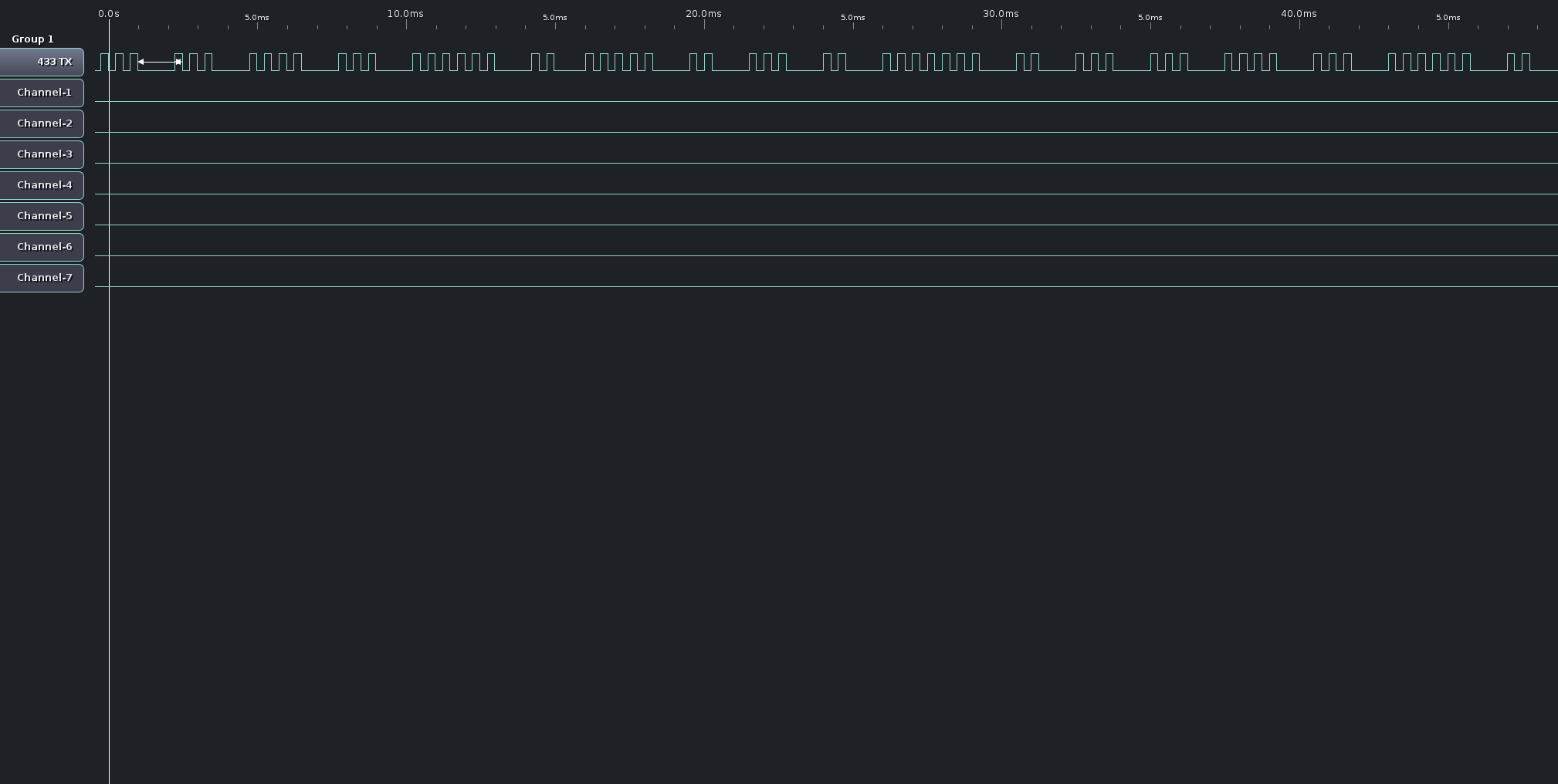

Posted at 2014-11-03 by thomc I got the logic sniffer on the case and sure enough you can see my signal is not right compared to the working one. I have something to work with now :) Attachments: |
Posted at 2014-11-03 by @gfwilliams Great, thanks - that's a huge help. Which one of those waveforms is the one that comes from Espruino, and was that with the code that I'd posted? |
Posted at 2014-11-03 by thomc Sorry I thought it would label them. The top one is the output from the Arduino which works, bottom one is my Espruino code. I've attached wave form of the code you posted below. Attachments: |
Posted at 2014-11-03 by @gfwilliams Ahh, thanks. So I guess that's what I thought - your original code was probably fine, but was running a bit too slowly to put the pulses end to end. And I was trying to be too clever in my code. Due to the awesomeness of JavaScript, it looks like the ternary operator doesn't treat the string Try:
Posted at 2014-11-03 by thomc I'm so impressed you are programming this blind. That looks a lot more respectable in the output, just not quite the right pattern. When I was going over the code, I did notice that perhaps the "byte start bit" was missing. It looks like this is going to work though, just need to find the bug.Attachments: |
Posted at 2014-11-04 by thomc It works! Thanks @gordon, your code worked great. I realised you'd already added the byte start bit as per your comment once I traced through the code. The sigLength was of course needed, I'd forgotten to adjust that too. So for anyone else wanting to try this, hook up the 433 to Espruino as per the tutorial on the Espruino website. Use this piece of test code:
