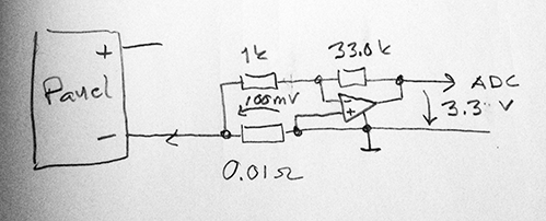

Posted at 2015-01-18 by tage correct, you get better accuracy if you amplify the current sense signal. for 10A current I would use a 0.01ohm resistor, which gives 0.1V voltage drop at 10A. then amplify the signal about 33 times to get better use of he full scale 3.3V input range of the ADC.Attachments: |

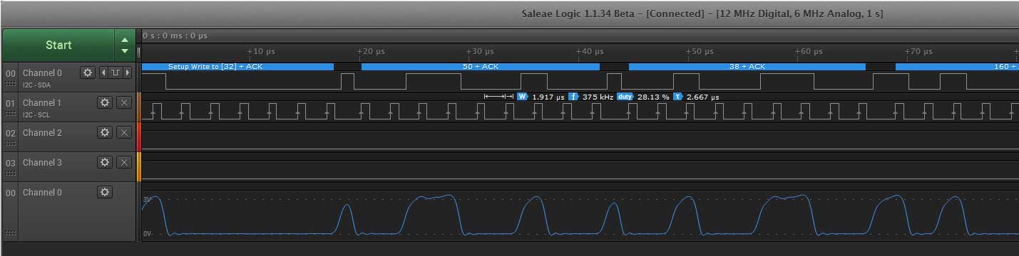

Posted at 2015-01-20 by tage it works! I had some trouble finding the latest build (not a programmer by any means) but then I stumbled onto drazzys bigram builds and tried the latest one, successfully. now I just need to replace the 10k pullups with something else more suited for 400kHz and 3.3V..Attachments: |
