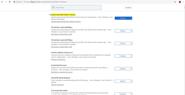

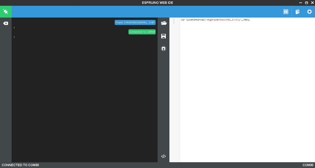

that it is note: also you need ST LINK drivers !!! I have problem with COM port on Espruino Web IDE, I can't connect my board with IDE Posted at 2020-10-17 by AkosLukacs Which web-ide you use? There is (at least) the in-browser version at https://www.espruino.com/ide/ You need to enable web-serial, and that requires a recent chrome-based browser (for example Edge and Vivaldi does work) There is the Chrome web app https://chrome.google.com/webstore/detail/espruino-web-ide/bleoifhkdalbjfbobjackfdifdneehpo (should work without any extra steps) And there is the native NWJS based app (that should also work without extra steps) Posted at 2020-10-17 by IvanJ hi [url=https://ibb.co/K66ycY8][img]https://i.ibb.co/6YYsc2q/pic-8.jpg[/img][/url] Posted at 2020-10-17 by IvanJ But Native is working I am so excited!!! Posted at 2020-10-17 by IvanJ I get it...this button in IDE with arrow pointing up is upload...ok Posted at 2020-10-17 by AkosLukacs Upload button in the middle! Attachments: Posted at 2020-10-17 by IvanJ Thanks! Posted at 2020-10-17 by pankleks I have board with STM32F411CEU6. Not sure which firmware to use -> I'm trying now with Posted at 2020-10-17 by pankleks Thank you @ivanj - I followed your steps, upload firmware via STM Cube went without any issues, installed Virtual COM, see COM7 (STMicroelectronics), but when I try to connect with putty or other terminal - there is nothing (no messages, no prompt). I'm currently doing all of this using UART (on PA9/PA10). Posted at 2020-10-17 by IvanJ When you open Putty just press Enter on keyboard and type Posted at 2020-10-18 by @fanoush

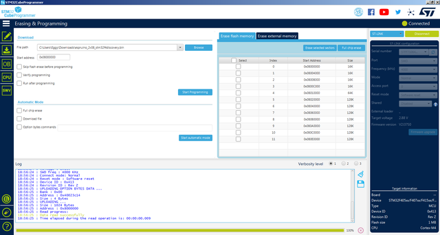

Hi to all.
I flash Espruino firmware on STM32F4 discovery board
with success. Also I installed Virtual COM port drivers with success
but I have problem to connect my board with Espruino Web IDE, I can't see
COM port of my board. What is the problem?
Thanks in advance
