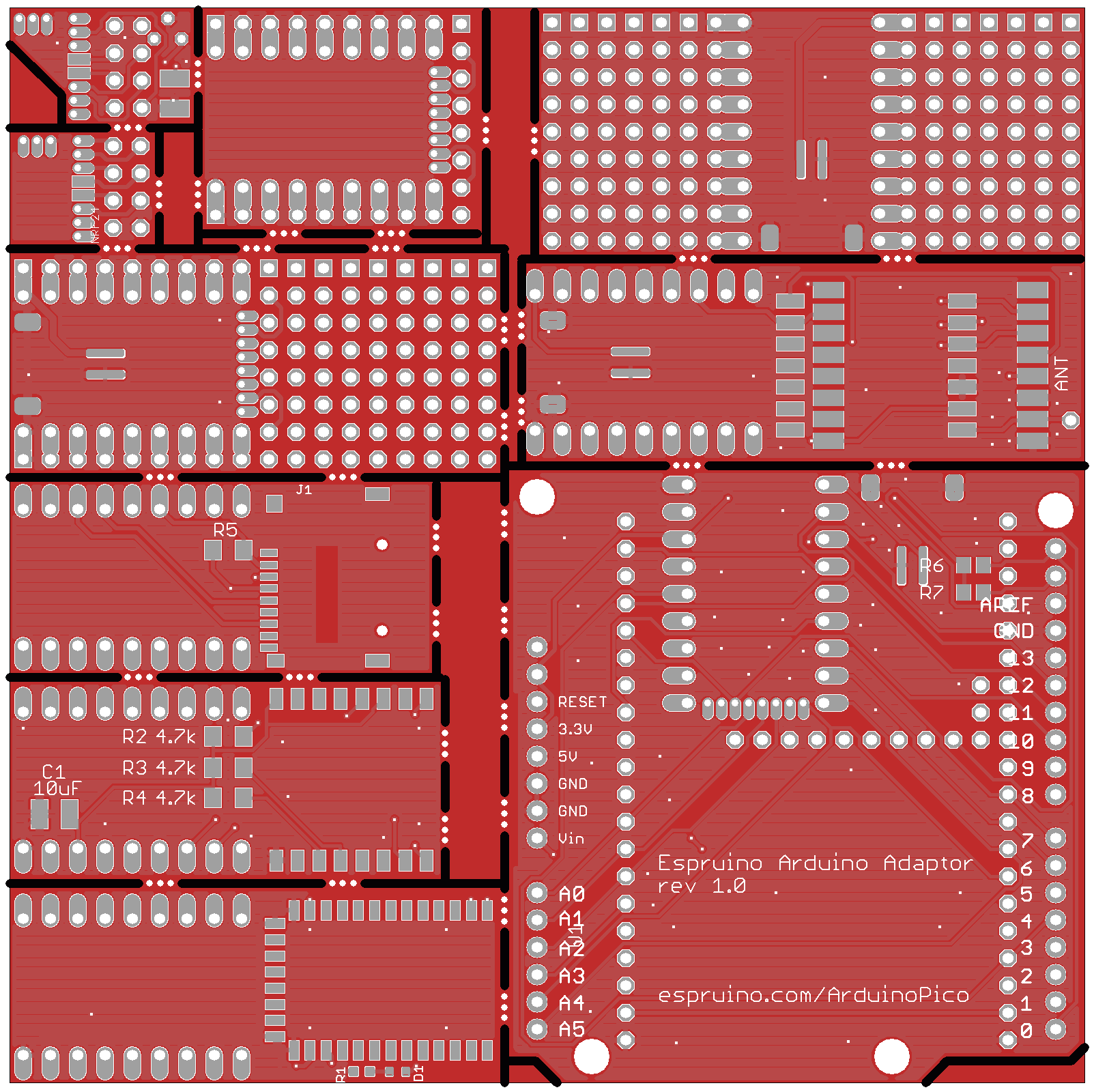

Posted at 2015-09-22 by @gfwilliams Ok, this is what we have so far:
Any thoughts for the remaining space up the top?Attachments: |

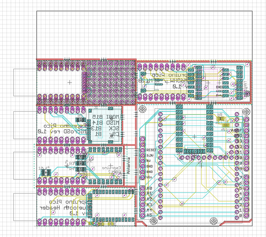

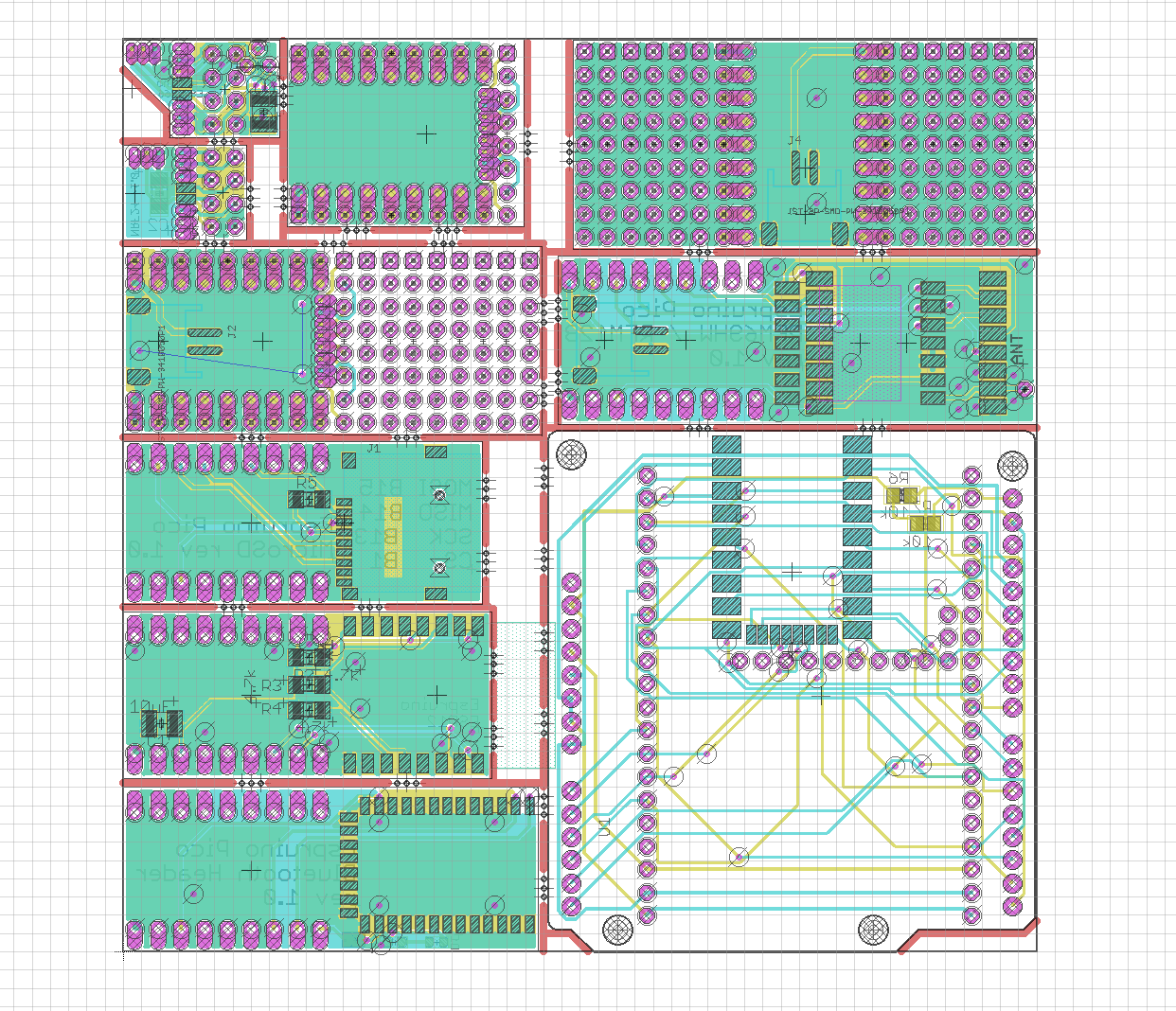

Posted at 2015-09-22 by @gfwilliams Ok, NRF24 and ESP01 added, as well as a breakout for the 0.05 inch pins and another prototype board. Any thoughts? I think I'll put an order in for some of these today.Attachments: |

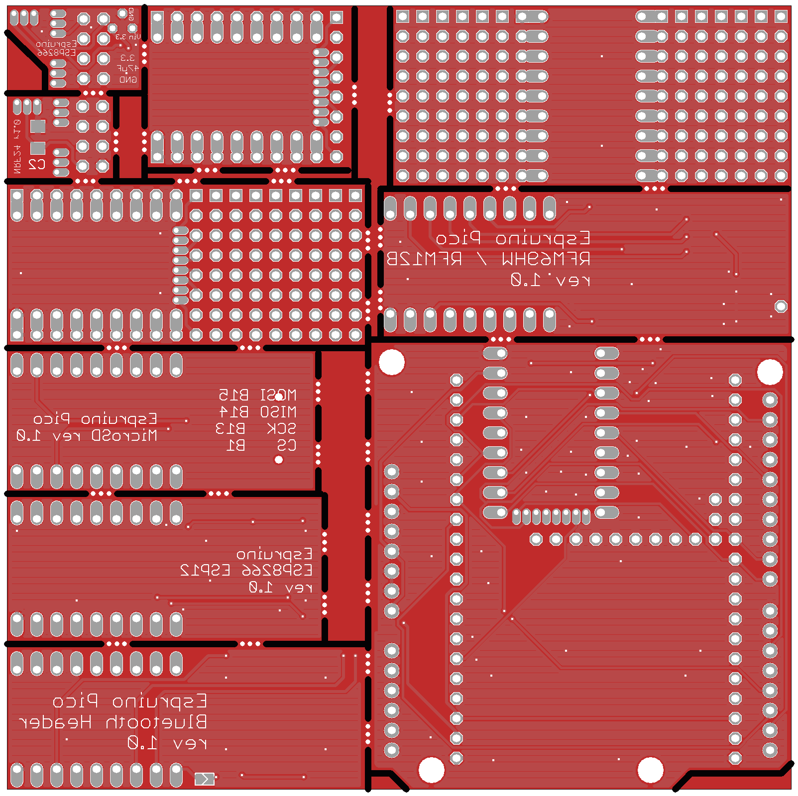

Posted at 2015-09-22 by @gfwilliams Well, it's done now! I guess I'll see whether it worked in 2 weeks. Picture is from DirtyPCBs' preview, which looks promising.Attachments: |

Posted at 2015-09-22 by DrAzzy I find perfboard almost totally unusable. The holes aren't connected, so what good is that? A pin connected to only one thing isn't very interesting... Every time I've worked with it, it's been an awful experience. That's why the protoboard I make has the holes connected together in groups (of 2, 3, or 4). What's the third up from the bottom on the left? is that for a micro SD card slot? If so, be sure to specify the SD card slot part number and make sure it's available. My uSD card sockets look very different! I think they may be supposed to have a decoupling cap, too. Also, I don't like the look of those really narrow strips between the boards - why bother cutting out those little strips, instead of just making one of the boards a hair bigger? |

Posted at 2015-09-23 by @gfwilliams
Yep, MicroSD. It's the one the original Espruino uses, from Seeed's OPL - but yes, I'm going to have to link to suppliers of all those parts. Good point about the decoupling cap. I've done a board previously and it works fine, but it wouldn't hurt having the pads there :)
It's just that each board is its own eagle design, so it's a pain to get the sizes exactly right. We'll see how it turns out!
:) It's not perfect, but it's better than nothing. On such a small area it also gives you a choice of which orientation you put the chips in - but yes, if you have a massive protoboard then having some proper connected pads is better. |
