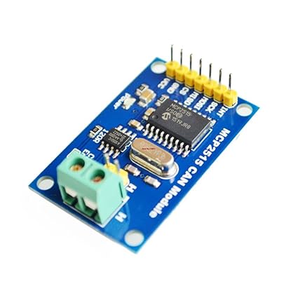

Posted at 2016-05-28 by dwallersv Well. Three year old thread. Did anything ever happen with this? Here's why: CAN bus communication is part of my bigger project (which involves WS2812B lightstrip control as well, as some of you know from my other postings). I got one of these on Amazon, 8 bucks: CHENBO(TM) Smart Electronics MCP2515 CAN Bus Module TJA1050 Receiver SPI I've been studying the datasheet for MCP2515, and there is an Arduino library for accessing this chip to reference. So, if no one else has implemented anything with the MCP2515 to interface with CAN, I guess I'll be contributing a module to the community soon... If there is already code out there, a pointer would be greatly appreciated! @gordon: Much more than just OBDII (diagnostics). Virtually everything that happens in a modern car is sensed and controlled via messaging over CAN and LIN digital master/slave buses. Once on the CAN bus, it's possible to have an Espruino do all sorts of neat things. Controlling windows; entertainment; lighting; and on and on. Access to every parameter the car either senses or synthesizes. |

Posted at 2016-05-31 by @gfwilliams I think CAN is only available on the STM32F103 (the original Espruino) and not the F401 in the Pico? I'd really recommend trying the MCP2515... It looks good. I could be wrong, but it seems like you probably want some kind of line driver chip as well - so if you're wiring an extra chip up you might as well just use one of those CAN modules with the MCP2515 on too? It'll also be a lot quicker to develop as you can write the whole MCP2515 driver in JS. My point about the ELM323 was just that if you're plugging in via an OBD2 plug, it's actually cheaper to buy the whole plug + ELM323 than it is to buy the plug and wire it up yourself :) |
Posted at 2016-06-03 by dwallersv Good points, and I didn't consider that the Pico has an M4. Also, I do have the Chenbo board, which has the line drivers on it already so can wire right in to the bus in my car. Changing my mind again :-) Re: ELM323 -- ah, got ya now. I need to do this anyway for the lighting project I'm working on, so I've got to bite the bullet. |
