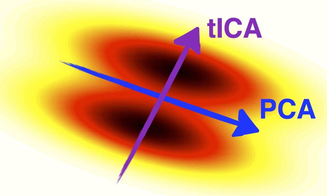

title: Decomposition
Reduce the dimensionality of your data
tICA finds the slowest degrees
of freedom in time-series data
>>> from msmbuilder.decomposition import tICA
>>> tica = tICA(n_components=2, lagtime=5)
>>> Y = tica.fit_transform(X)
Also check out PCA and SparseTICA
http://msmbuilder.org/3.5.0/decomposition.html

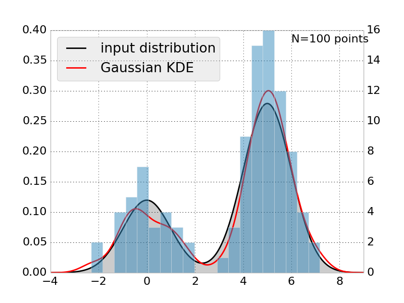

title: Hidden Markov Models
KDE is to histogram as HMM is to MSM
We also offer two types of HMMs:
  • GaussianHMM - Reversible Gaussian Hidden Markov Model L1-Fusion Regularization
  • VonMisesHMM - Hidden Markov Model with von Mises Emissions
HMMs are great for macrostate modeling!
http://msmbuilder.org/3.5.0/hmm.html
